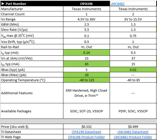

I am looking for a direct pin to pin part replacement of LMC6482IN_NOPB, which can operate at +/- 15V. Please let me know about a suitable part which is direct substitute.
Hi Sumeet,

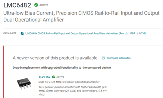

The equivalent and p2p replacement may be TLV9152.
Here is the comparisons. However, either one is able to supply up to +/-15Vdc. Could you tell me about the application and cost range? I will recommend one for you.
Raymond
application is filter circuit for demodulator/modulator, and cost is not a concern, main concern is direct replacement of LMC6482 which work
