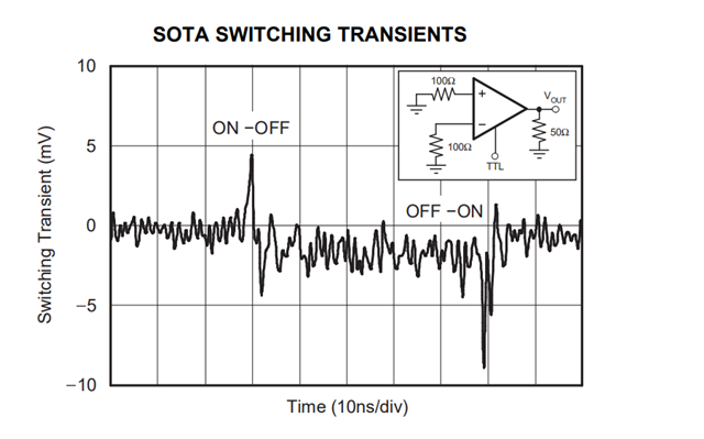

I have not found any information about input offset drift of the SOTA-part of the OPA615.
How bad does this part behaves under dc-precision aspects?

Hello Tom,
That is a good point, it is referred as switching transients for this specific device, but could not locate that was measured over temperature:
