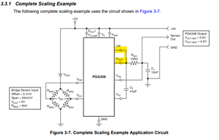

I am a new user of this type of component, and so I used the guide provided in the datasheet, "PGA308 User's Guide (SBOU069)," to base my understanding of the system. To set the context, I am using an Arduino Mega to test the component initially, with a DAC8555 to simulate the two sensor outputs, Vin1 and Vin2. For the Vout, Vf, Vsj, Vs, and Vref pins, I used a setup similar to the one shown in "Figure 3-7," with the Dout/Vclamp pin left floating and the 1W pin connected to the UART port of my Arduino (Rx and Tx).
For the software part, I started by putting the component in "Software Lock Mode." Then, I began writing and configuring the ZDAC register to observe a change in the output voltage "VOUT" using the frame explained in "Figure 4-2," with the UART baud rate set to 4800 bits/second. However, the parameter still does not change. I also tried reading from the same pin using the command from "Figure 4-2," but I obtained a voltage of 3V that only changes when modifying the two input voltages.

    In Figure 3-7 of the User's Guide, the PGA308 is configured in three-wire mode, meaning the 1W is connected to VOUT:
    There is an existing e2e with a similar issue, see here: (+) PGA308EVM: Software Lock Mode - VOUT not enabling after programming the registers - Amplifiers forum - Amplifiers - TI E2E support forums
    Mostly focused on this portion of the response:
    For the purposes of evaluating the device with your arduino, I recommend separating the VOUT and 1W and implementing the following code with your UART:
    Most engineers have a much easier time by ordering the PGA308EVM and using the GUI to first evaluate this device, I recommend this.

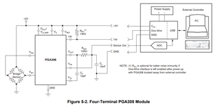

    I recommend to setup the PGA308 in the following configuration:
    I recommend having an extremely small wire between 1W and your UART communication, if not the following will also need to be implemented:
    If you are not using the EVM, does this mean you have a custom board? Can you share the schematic?

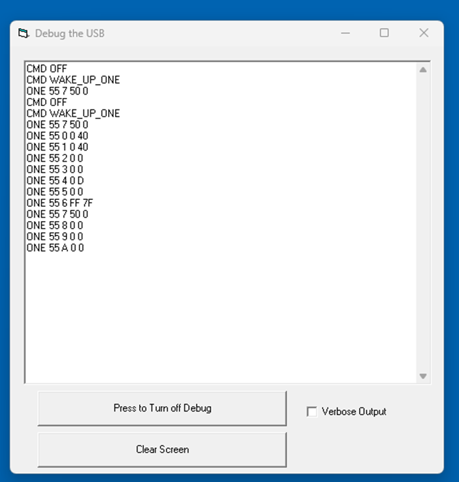

  • Hello Carolina,
    I was able to establish the connection properly, and I can now read both the default registers and those after configuration. So the communication with the registers seems to be working fine.

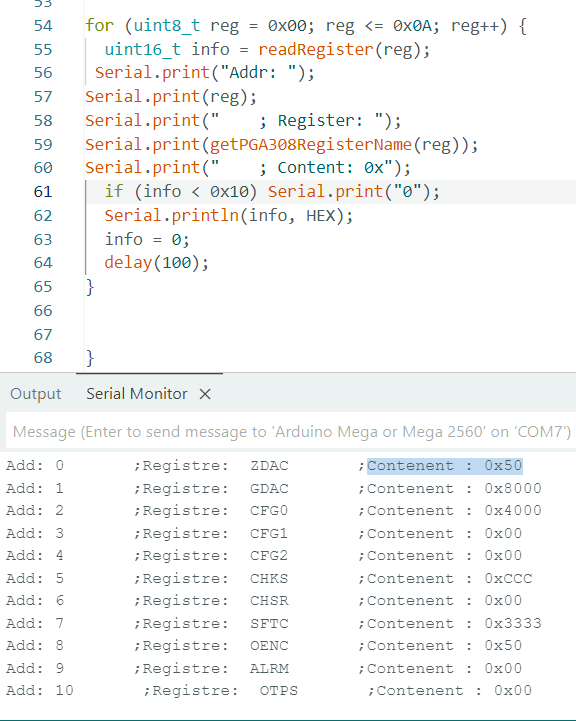

  • And I also have a small issue: when I start reading, it begins with the value I programmed in the SFTC register — even if I request to read register 0x00, which is the ZDAC.
  • Hello Ferhat,
    Your understanding of VClamp and DOUT is correct.
    I am not sure what you mean by this, could you share more details:

  • Hello Carolina,
    I just wanted to mention that when I start reading the content of the registers using the function I referred to yesterday, it consistently begins by reading the SFTC register with the value 0x50, before proceeding to read the other registers.
