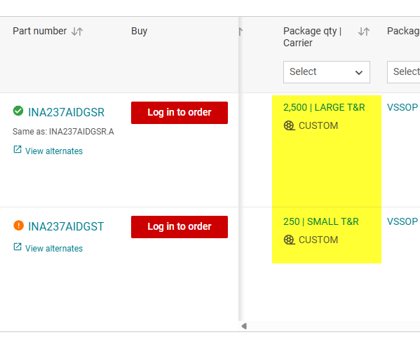

  • Hello Sivakrishna,
    To elaborate a bit on Mitch's response, only the small tape-and-reel version indicated by the T at the end has gone obsolete.  The large tape-and-reel version indicated by the R at the end is fully in production and will remain so:
