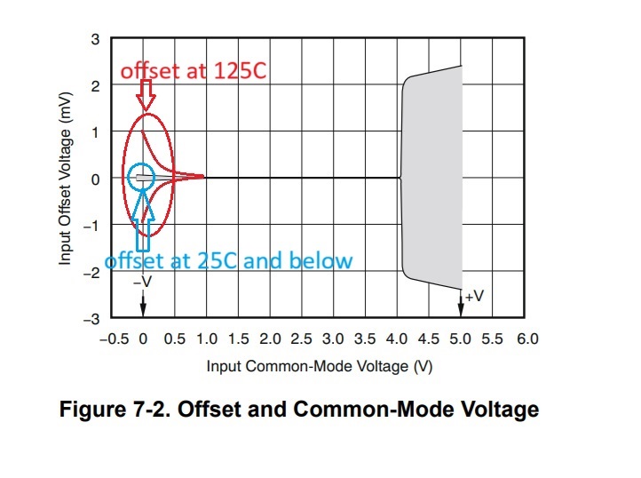

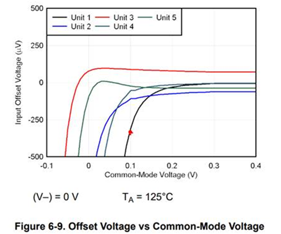

We would like to check some specification in datasheet.
1. Do we have TA = 25C and TA = -40C test result could be information?

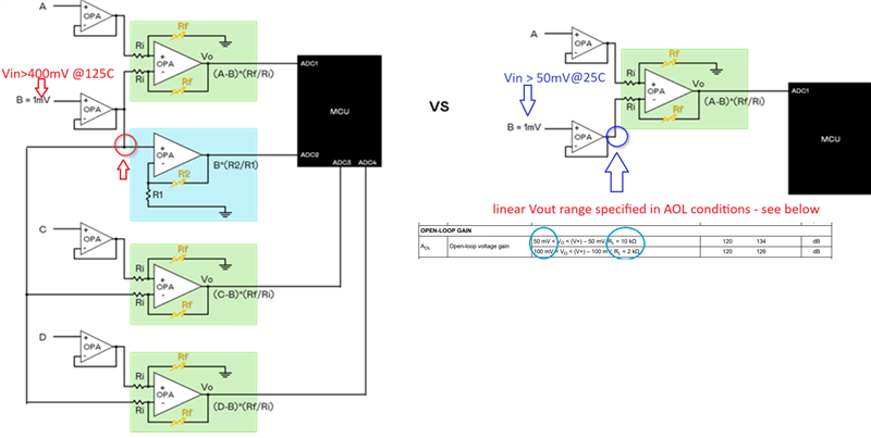

2. We would like to check if red circle node has risk because it is used by multiple OPA.
May you share the comment if red circle and blue circle have the similar performance or not? (only 1mV)
