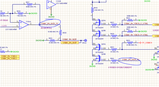

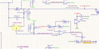

TLV3511: Higher current drive
Part Number: TLV3511
I am powering my LT1716IS5#PBF comparator from 5V. It is not able to drive > 60 uA. I need a comparator with rail to rail output that can support a higher drive. It also drives the gate of a MOSFET 2N7002DW. Will this work as a replacement?
TLV3511QDBVRQ1
