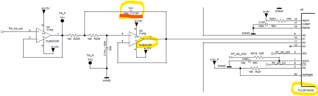

TL082: ask the usage of capacitor between the output PIN and input PIN5
Part Number: TL082
Other Parts Discussed in Thread: TLC2574
I am confused with the C192 capacitor, the C192 capacitor will lead the positive feedback of the input signal of TL082.
Normally, we design the circuit will avoid the positive feedback, it will lead to the circuit instability.
So I wan to look the support from you Why this circuit will use the C192(100nf) in the output PIN and input PIN5?
Any concern from the TL082 or TLC2574 component?
this circuit is used so many years and no problem.
