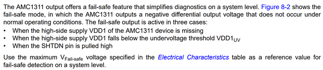

we are using a AMC1311B. What happens with the output voltages (OUTP and OUTN) when the input side of the AMC1311B is without power (VDD1 zero)?

  • Hi Ralf,
    Thank you for your question. Section 8.3.3 of the datasheet describes the fail-safe behavior which would occur if missing VDD1.
    Please let me know if there are any further questions.
