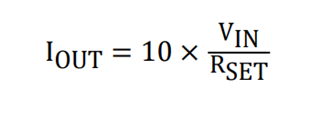

    We do have 4-20mA current transmitters that have variable transfer functions. XTR111 and XTR200 both have the following equation:
    Now both of these devices are 3-wire transmitter versus the XTR115 2-wire so there's some major design considerations.
    Let me know your thoughts.
