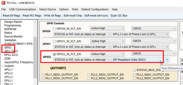

I recently just received the LMK5B33216EVM for our testing. I followed the recommended quick start instructions, where I have all the jumpers in their default configuration and I am supplying 12V to VIN4. I measured at various test points and noticed that they are roughly at the correct voltage level.
In TICS Pro, I noticed that I am unable to select any section on the USB2ANY interface, as the option is grayed out.

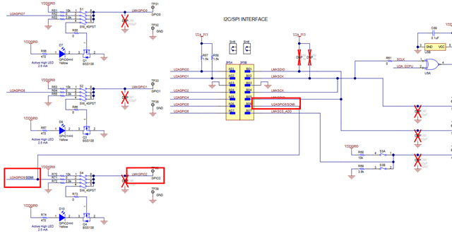

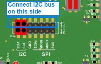

After one of the firmware failures, I am no longer capable of talking to the USB2ANY chip. Whenever I press the BSL button, I receive the Windows message: "USB Device is unrecognized". I am not sure how to proceed and could use some further debugging assistance.
To Touch on this further, when I press and hold the BSL button my PC's Device Manager shows that the USB port is unknown due to device descriptor message failed. My total current is at 380mA. When I was able to connect to the USB2ANY chip on the USB2ANY explorer, I was getting 400mA. Ever since one of the failed firmware updates, I have not been able to reconnect to the chip.
I believe that there are problems with the USB2ANY chip on my board, please reach back out soon. If that is the case, is there a way that I can still use the EVM via other ways of programming the LMK part?
