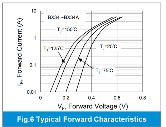

    Secondly, The selection of diode D1 is wrong.The parameters of the diode are shown in the figure below.
    What I want to know is, does this pull-up problem can cause problems with the input pins, such as threshold voltage deviation from the set value.

    If output only goes to input of this chip and all supplies are 3.3V , then what is the purpose of D1? It seems to be not needed to me.
