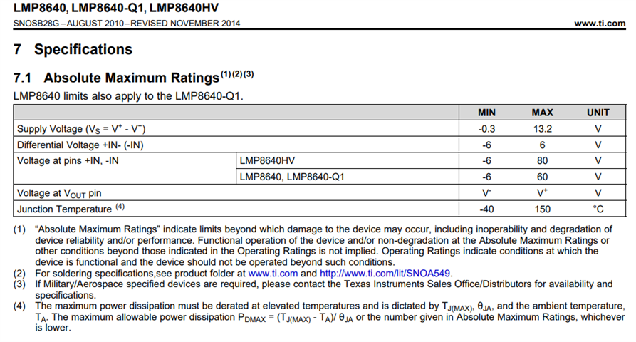

    Normally we recommend lower than 10Ω at the input due to the input bias.  Also is R66 51Ω?  I do not think that is correct.  Is there anything in their circuit that could be causing our inputs to go beyond the absolute max ratings, even during transients?

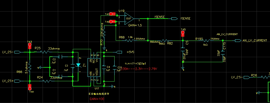

    What is the effect if customer use 33ohm rather than <10ohm?

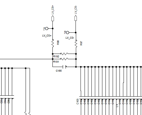

    And R66 is indeed 51ohm. But it is not the shunt resistor. Shunt resistors are R191 and R192 as below. Both are 0.2mohm. Which means actual value of shunt resistor is 0.1mohm. Current is 30A. Differential voltage should be 3mV(0.1mohm x 30A=3mV). Common voltage is 28V. Is it ok?

    Why is R66 installed?  What purpose does it serve?  This will cause additional current running on the sense line beside the IB needed for the LMP8640.
    I would confirm that the voltage on the bad device and good device are the same at the inputs of the LMP8640.  TP43 and TP44 are not good enough as the 33Ω resistor will impact the measurement.  Having different IB could cause differences in output voltages but I would not assume to the amount you are seeing.
    The layout of the parallel 0.2mΩ can impact measurements as well but I would not expect and ABA swap to be much different.
