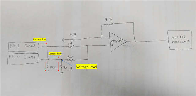

Hi Team
could you help me check below non-inverting summing amplifier is available for you?
or do you have any other recommendation solution for this applcation.
BRs
Brian

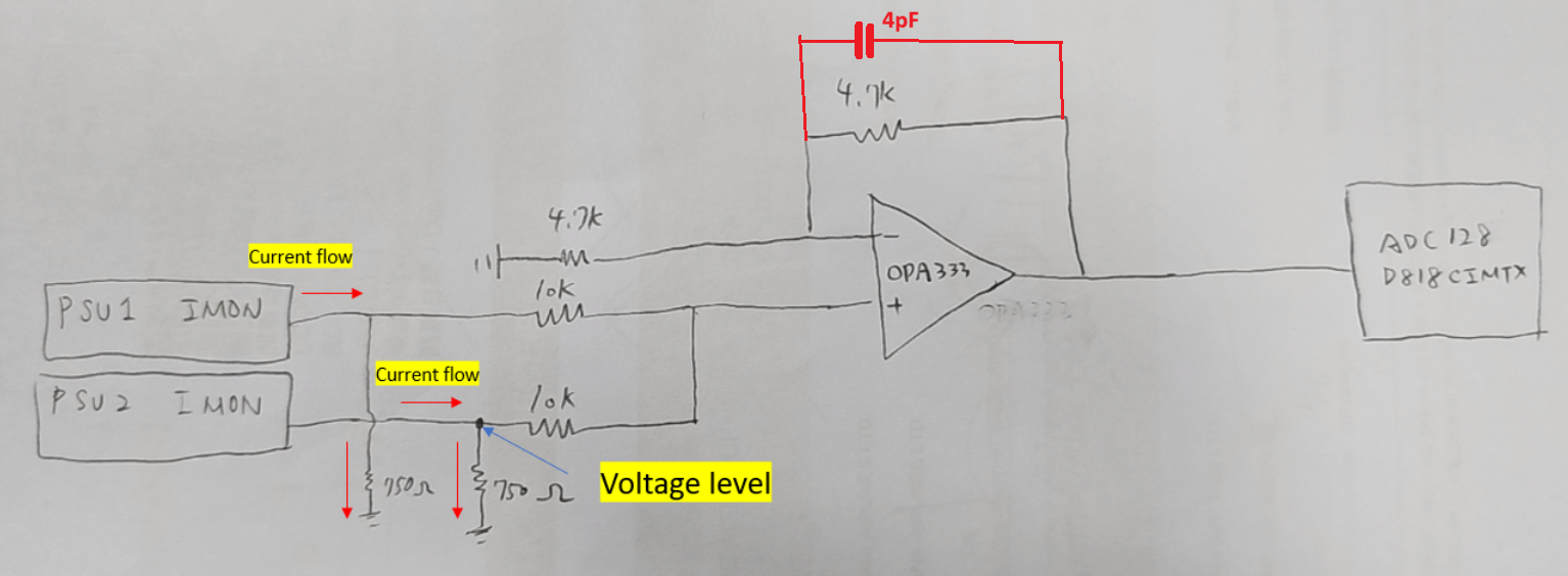

Hi Marek
because IMON will provide a constant current source so they need a resistor to produce voltage for AMP reference.
do you think the application is ok for you ?
appreciate your great support:)
BRs
Brian
The circuit looks fine. Just make sure in your calculation you account for the fact that some of the difference between PSU1 and PSU2 currents would flow thru two 10k resistors. That’s what makes it a summing amplifier.
