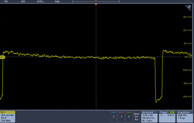

    Is the oscilloscope AC coupled or DC coupled? What gain resistor is in use when the noise is being observed? Typically popcorn noise will be a current noise on the input transitioning between two discrete states. Please see below image for an example. This is most frequently seen with high input impedance, and in high gains.

    With a gain of 23, your input noise will have to be 6.21mVpp to show up as 143mVpp on the output. With a typical 0.1-10Hz noise of 0.7uVpp, this is very unlikely. If this is caused by a current noise, a 6.21mVpp with a 10kOhm input resistance would mean that your input current noise would have to be 621nApp. The typical noise of this device is 7.3pApp. This means it would have to be 100,000 larger than typical noise. Both of these feel unlikely, but may be thrown off by the high frequency components of the noise.
    Is the output filtered at all to remove high frequency components of the noise? I would recommend a 120kOhm and 10nF capacitor on the output connected like the below image:
    The behavior does not appear to follow the typical characteristic of popcorn noise in the oscilloscope, but this may be due to the high frequency components of the noise.
    For an occurrence rate of 1 out of 14,520 it is a similar occurrence rate to popcorn noise. TI does test this device for popcorn noise, but due to the random nature of popcorn noise, it is not possible to screen out this behavior 100%. If this is popcorn noise, this is an inherent risk when designing with any bipolar amplifier.
