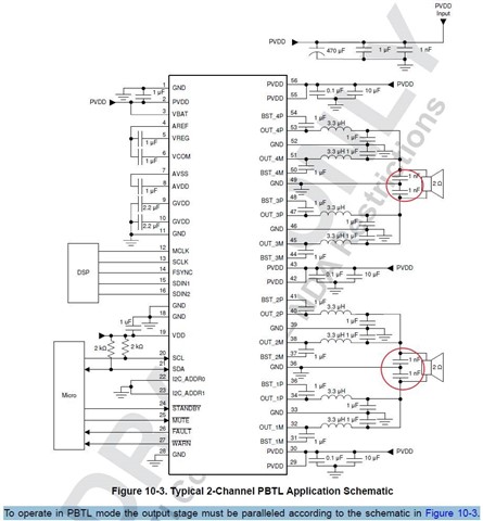

Hi team,
Can customer remove the 1nF capacitor when use the PBTL connection?
Xiaowei Zhang
Hi team,
Xiaowei Zhang
Hi Xiaowei,
The 1nF should be located near the connector for EMC. I do not suggest the customer to remove this capacitor.
