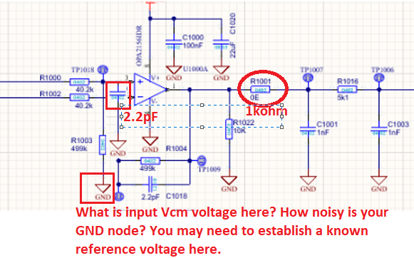

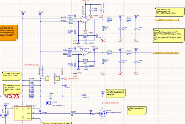

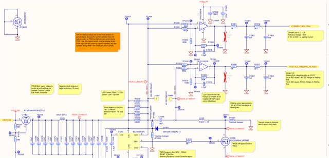

In my application, a LED Current controller drives current up to 16A.
4 in parallel sensing resistors create a sense resistor of 12.5mOhm. The voltage accross the sense resistor will be amplified by OPA2156 by factor 12.4. The voltage accross the load will be attenuated by factor 2.5 with the same Amplifier OPA2156.
Referring to the schematic:
When the current controller is operational, during ON time, a certain voltage drop on VSYS can be seen, which is reflected fully on the output of U1000A.

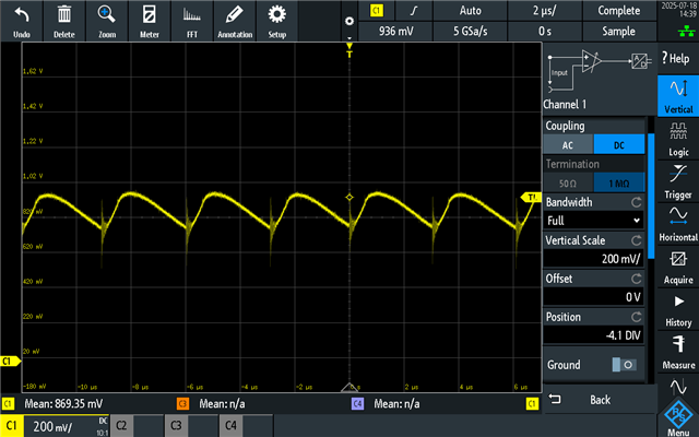

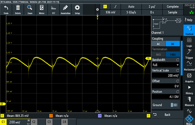

The PWM frequency of the current controller is between 250kHz and 300kHz. The OPAMP has a fairly high slew rate and GBW product of 25MHz, which is results in around 2MHz Bandwith with Gain 12.41. Yet, the OPAMP seems not to amplfied the difference but also the voltage swing von VSYS. I am seeing a voltage swing of around 200mV on the output of U1000A, while the input swings as well at around 200mV.
VSYS can be from 10V to 26V. We see very different output results from U1000A between these voltage but I should be same.
I suspect the feedback current to be too low on R1004 and reduced R1004 / R1003 to 49.9k and reduced R1000 / R1002 to 4.02k. This led to some minor improvement, but yet the performance of the current amplififer is not good enough for our application.
U1000B works just fine, we see almost no output voltage swing (I suspect attenutation by 2.5 helps a lot).
Now we need hints to improve the measurement accuracy of U1000A.
The measurement is taken at TP1006.
Thanks Martin

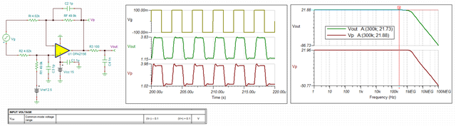

    If I understand the above statement, you want to capture the PWM current between 200-300kHz, then you will need to have at least 2.5MHz-3MHz BW to capture the switching signal.
    Please try the following, it may be good enough for the application. 49.9kohm||1pF is approx. 3.2MHz at -3dB, and it seems to be ok to measure up to 300kHz signal (with minimum attenuation and adequate phase margin). In theory, you would need slight higher op amp BW or reduce the gain slightly, say down to 10V/V.
    An op amp can not drive capacitive load directly and it needs to have a resistor in front of it, say 100Ω to 1kΩ, but you should open up the pole in RC filter up to 2MHz range (the simulation is seen the pole for RC filter is up to 1.6MHz).

    So that is the main issue we are still having, the output result (the amplfied analog Voltage from the current measurement varies by 10 - 20% from 10V to 26V supply voltage with the same set current demanded from the current controller). It is actually on some boards we see that the current measurement output from the OPAMP increases by 20%, sometimes it decreases by 20%. It is, if component tolerances decided if the OPAMP output voltage goes up or down with the same set current.
    The load for the OPA2156 is the ADC from a microcontroller. So what you see in the schematic above is mainly what there is, except for the Microcontroller ADC input pin.
    As for the Output load: Since R1022 (10k) is not assembled, there is no real load for the OPAMP, except there is on the feedback circuit. Considering the installed resistors (which we reduced by factor 10 with respect to the above Schematic), according to my calculation there should be power dissipation in the range of 10mW which should not lead to 39°C case temperature. But ok, i agree, 39°C is still ok, but the thermal imager shows this area as one of the hotspots, which is still somewhat unclear to me.
    To be clear, noise is not the issue here. Noise is in fact quite ok. It is as mentioned above, that we see a significant change in the OPMAP's output voltage, when we sweep the power supply from 10V to 26V, while the current controller is active. We do know, that the current controller also has issues in maintaining a constant current throughout the whole supply range and that is ok. The issue really is, that we sometimes see a decrease in the OPAMP's output voltage, sometimes an increase in the OPAMP's output voltage. If it were always an increase, I would not complain, but there must be more, than the eye meets.

    Input CM voltage is ok in my opinion. You can verify yourself by assuming 10V to 26V for VSYS on the above schematic with the voltage dividers before the OPAMP + and -. I think we have enough room to the rail and CM voltage is overall within range for every voltage from 10V to 26V. Do you agree?

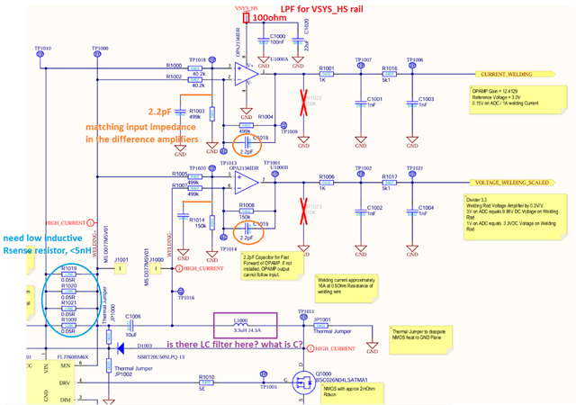

    Here is the current schematic.

  • Hi Martin,

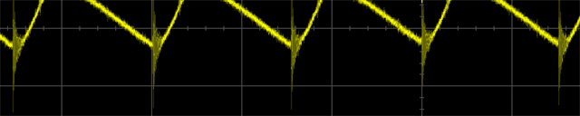

    I noticed that there is ringing on the waveform. Is it generated by your LC filters?
    Let us try a few things.
    1. Place 100 ohm at VSYS_HS rail and form a LPF
    2. Add 2.2pF to the marked locations. The input difference amplifiers need to match the input impedance very precisely. Your difference amplifiers' CMMR is no better than 60dB currently. You may consider to consider to limit the op amp's BW by increasing 2.2pF. 499kohm and 2.2pF are approx. 145kHz. so the lower difference amplifier should match the top one, or 159kohm with 7.2pF/6.8pF or 7.3pF capacitor in parallel.
    3. The Rsense may have some parasitic inductance in them. Although parallel these helps a lot, please make sure that individual one has parasitic inductance < 5nH. Say at 300kHz, the impedance is approx. 0.94 mohm,  4X of 50mOhm is approx. 12.5mohm. Even with 1nH parasitic capacitance (sum of Ls), you are talking about 1.9mohm, which is approx. 1.9/(12.5+1.9) = 13% error in the best scenario. So I can see that 20% of Isense variation just from the parasitic inductance.
    4. with fx = 300kHz, your LC filter pole should be at least 1/10 to 1/20 of 300kHz. I do not know what the system is configured for.
    Please improve some of circuit above, please let me know, we can fine tune the Isense measurement. It seems that you are doing DCM in current mode. Did you compensate all the pole and zero in the system and the load.
