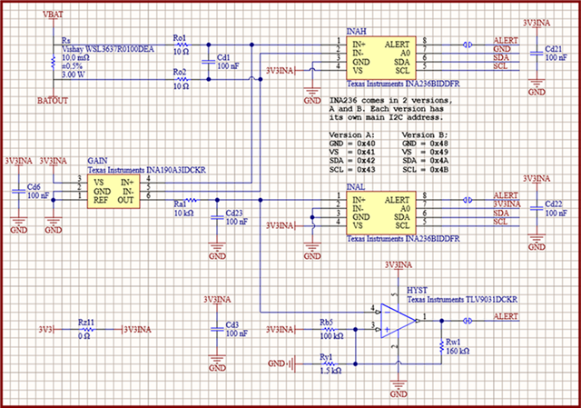

I need to measure the voltage applied to a load and the current that goes into it. Power comes from VBAT and goes to the load through a 10 mΩ shunt resistor (Rs).
Voltage and "high" current (up to 8.192 A based on INA236 full scale) is measured with the top INA236BIDDFR (INAH) with no problems.
I also want to measure "low" current, for when the DUT (device under test) is sleeping. For that I use the INA190A3IDCKR (GAIN) with a gain of 100, that lets me measure up to 20.48 mA with a LSB of 625 nA in a seconf INA236.
The issue I am having is that the GAIN output is oscillating. I found that the oscillation goes away if I remove the INAH IC. I also tried removing Ra1, with no effect (with INAH still soldered).

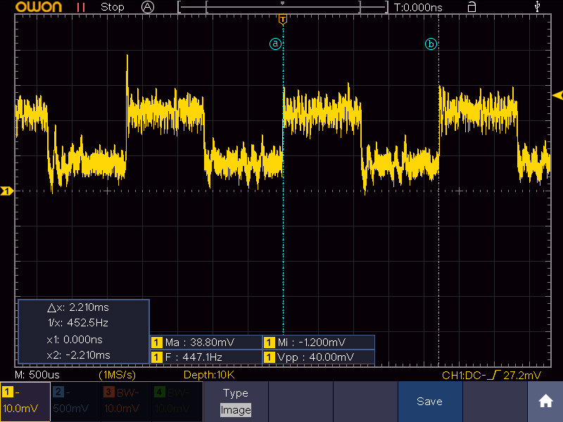

The oscillation itself, is a square wave from 10 mV (fixed) to 20 or 25 mV (dependent on the load current, which was around 4 mA when scope capture was taken) with a frequency of 450 Hz.
May you suggest an alternative to the INA190 or, maybe, a completely different approach with another IC that lets me measure “high” and “low” currents?
I haven’t tried it yet, but perhaps, adding a positive reference to the INA190 to get away from the ground rail helps eliminate its output oscillation.

    Looking at your oscilloscope shot, it appears to be switching from GND to ~12mV. This switching behavior is due to the sampling ADC in the INA236 that switches measurement between Vbus, Vshunt and current. There is also a 1.05 MOhm resistor to GND on the IN- pin internally that draws current when ADC is sampling Vbus.
    To eliminate this oscillation effect you could:
    1. Alter the register settings such that Vbus is not measured at all (Configuration Register -> MODE -> Continuous shunt voltage)
    2. Alter the conversion time of the bus measurement, make it longer
    3. Remove the 10 ohms resistors (R01/R02) in the sense line.
    Assuming your Vbat is 12V, when the ADC is sampling Vbus, the current coming though IN+ is " I_IN = 12/(1.05M) ~1.14 e-5 A. When you have 10 ohm resistors, then there'll be a voltage drop across them of " V_drop = 1.14 e-5 A* 10 ~ 115 uV , after a gain of 100V/V, the INA190 output is ~ 11.5mV." This the voltage the output of the INA190 is oscillating to, so by removing the resistors there'll be no voltage drop in the sense line and the oscillation should stop

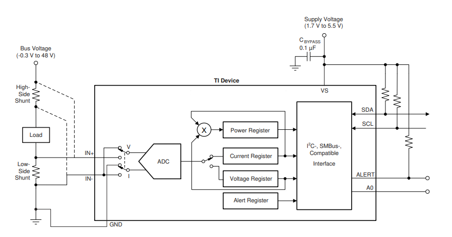

    I found in the datasheet that the INA236 can work with "large" shunts. I can't see how large "large" is.

    There isn't a specified upper limit to how large a Rshunt you can use. This depends on how small a current you want to measure and how much error you can tolerate. Please see our Error-Tool Calculator, you can use it to find the best Shunt for your system.
