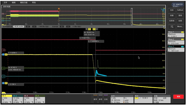

Customer is using this device and found there is a glitch as the OD is pulled down.  it seems expected based on DS's information.
Can you explain why there is a glitch? and Are there any ways to suppress this glitch?
CH1:XTR111 supply12V_AUX_S    CH2Imon output (IMON)  CH3:OD Imonctrl_DSP   CH4:XTR111 Vin (pin 6)

  • Hi Harry,
    It's easy to miss but there's two sections in the datasheet that talk about output glitch. The one that you showed talks about how to minimize it. The other section (6.3.2 Dynamic Performance) talks about where it comes from. Shown below is a snippet of that section from the datasheet.
    Besides the ways to reduce the glitch from the datasheet sections you have attached, you can also have a filter on the output.
