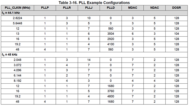

    Could you provide the PLL settings (PLLP, PLLT, PLLJ, PLLD, MDAC, NDAC, DORS) for the case of 22.05KHz and 16-bit?
    Xiaoxiang
  • Hey Xiaoxiang,

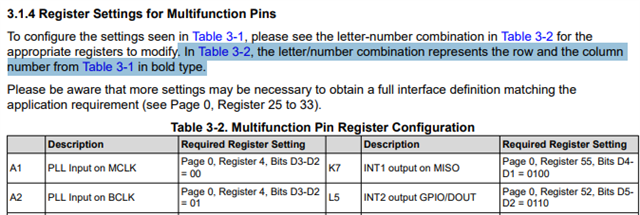

    First use the A2 instructions to select BCLK as your input
    Can you clarify in the thread how many channels you are using ? Also please clarify is the bit depth 16bit out of a wider word width ? for example 16 bit depth in 24 or 32 word width ? please clarify that as well.
    Once done, I could guide you through a hack on how to select values in table 3-16 to get a working PLL tree.

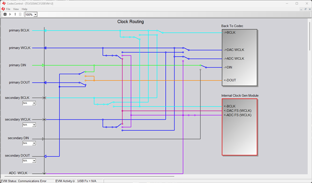

    Follow these instructions, for your specified example:
    1. Open CodecControl
    2. File -> New EVM Simulation ->Select any AIC device (do not select DAC device)
    3. Click on Digital Audio Processing block
    4. Click on Internal Clock Gen Module

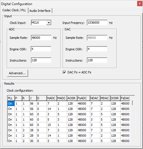

    5. At the new window, input the required values
      1. Input Frequency = 1536000 Hz
      2. Sample Rate = 48000 Hz
    6. Use the first or any of the other results for PLL settings, make sure to also use the values for NDAC, MDAC and DOSR.
