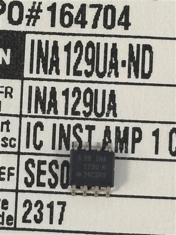

Customer would like confirmation on marking. Attached is the image. The K is in question.
Hello Erik,
This topside marking appears consistent with our standard. What is the question around the K?
Gerasimos
Hello Erik,
The K represents the assembly site code. The assembly site should be on the label of the material as well.
Gerasimos
