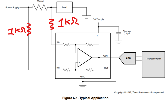

INA214-Q1: To change gain 90
Part Number: INA214-Q1
Hi, Team
One of my key customer, KyungShin need 90 Gain INA part. So INA214-Q1 is closest part and asking how to change gain to 90.
we know INA214-Q1 has 100 Gain. customer wants to change it as 90. So 1kohm is inserted at +in/-in as shown below picture.
Is this schematic is possible to be 90 GAIN from INA214-Q1? if not, can you recommend?
