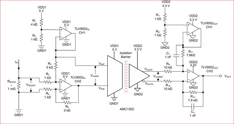

Hi everyone,

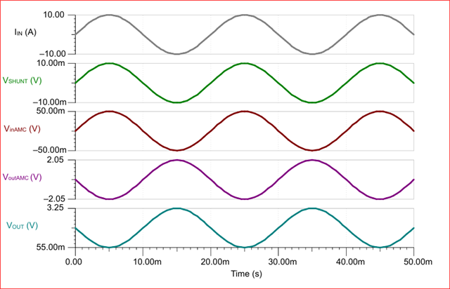

I am reading page 57 of Ti's Engineer's Guide to Isolated Signal Chain Solutions and I don't understand why the waveforms of VinAMC and VoutAMC have a 180 degree phase difference.
I would like to know why.

  • Hi Yi-Hsuan,
    It is because the positive input is being pulled up to 1V at all times and the input current is amplified on the negative input to swing the full-scale range. This causes the 180-degree phase shift shown on the output.

    The level liftng and signal amplification you mentioned are consistent with my understanding, but I still don’t quite understand the phase part.
    My current feeling is whether the waveform of VinAMC is wrong(phase or amplitude value)?
    I feel that VinAMC and VoutAMC should be in phase?
