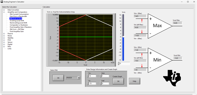

the transducer output DC2.5V+/- (0~2.5V), default 2.5VDC then connect to INA826 IN+, IN- connect to 2.5V REF, I want to increase signals 20 times as input, Vo= (Vin-Vref)*20 +2.5V(Vref), but it always output with 700mvpp,

Could you please attach a schematic? Additionally, what power are you supplying to INA826? Please provide both the voltage value and what is supplying this voltage (DC/DC, Power supply, etc)
Additionally, your transfer function will be Vo=(VIN+ - VIN-)*20 + Vref
You may check if your expected output is in the correct linear range using the analog engineer's calculator.
https://www.ti.com/tool/ANALOG-ENGINEER-CALC
