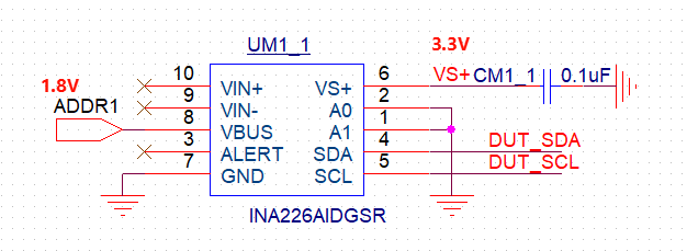

Hello:
The customer would like to confirm whether the theoretical service life of the chip can reach 5000 hours under the current circuit conditions and an ambient temperature of 125 degrees Celsius,Thanks!!
Hello:
Hello Jimmy,
Here are some relevant links for you to get this information:
https://www.ti.com/quality/docs/estimator.tsp?opn=INA226AIDGSR&cpn=&partNumber=INA226AIDGSR#resultstable (You'll be interested in the MTFB and FIT, but this is at 55°C)
https://www.ti.com/support-quality/reliability/temperature-change-FIT.html (You can use this to convert the FIT to 125°C)
Mitch
