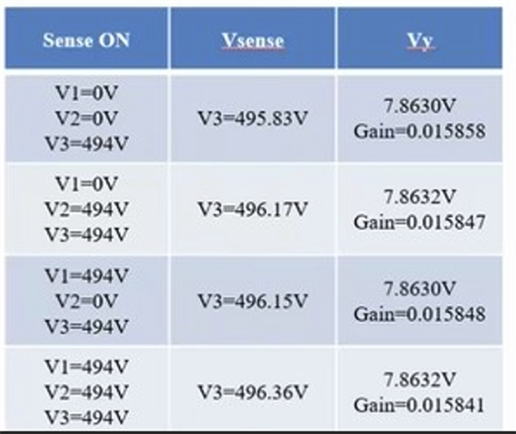

We're using three OPA192-based differential amplifier circuits to measure phase-to-neutral voltages (L1-N, L2-N, L3-N) of a 3-phase 400V AC system. Each amplifier senses voltage via resistor dividers, with all three circuits sharing the same neutral point (N) as reference.
[Observation]
When enabling only one phase (e.g., L1 = 494V, others = 0V), the output is stable (e.g., ~7.8630V).
However, when enabling all three phases together, slight variations occur in each output (~0.0002V), even if the input voltages remain the same.

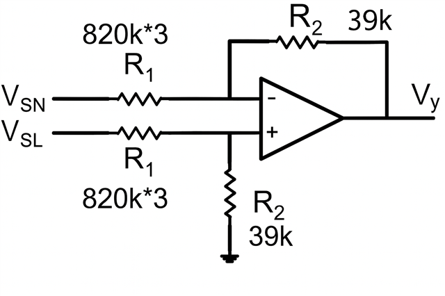

Current Design Snapshot:
  • Input: 3-phase 400VAC, each phase through voltage divider to OPA192 differential amplifier
  • All three amplifier circuits share the same N as reference
  • Gain ≈ 0.01585
  • Output range: ~7.8630V per phase (at ~494V input)
    This implies that the difference amplifier is attenuated at 7.8630/495.83 = 0.015858 V/V. or 39k/(3*820k) in attenuation.
    Confirmation on whether this cross-regulation issue is inherent to shared-N OPA-based structures
    Yes, this is a typical due to imbalance or mismatched line impedance. This voltage may get worst if the Neutral is not stiff and allowed it to float or shift due to return currents (unbalanced phase currents). Typically, the Neutral terminal is tied to Earth GND or at the main distribution panel.

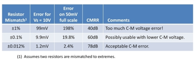

    OPA192 has an excellent intrinsic CMRR. I do not know what resistor tolerances you are using in the difference amplifier, which it should be around 0.1% in tolerance or better. If you want to improve the system's CMRR at OPA192, you need to use matching resistors to improve CMRR. Even with a high performance OPA192, small cross-cross talk is still there. In addition, the 3-phase system is shared the GND paths that can inject common-mod noise into the measurement.
    OPA192 difference amplifiers should be stable. You may consider to limit the op amp's BW and reduce the op amp's total noise, since the measurement is occurred around 400Hz.

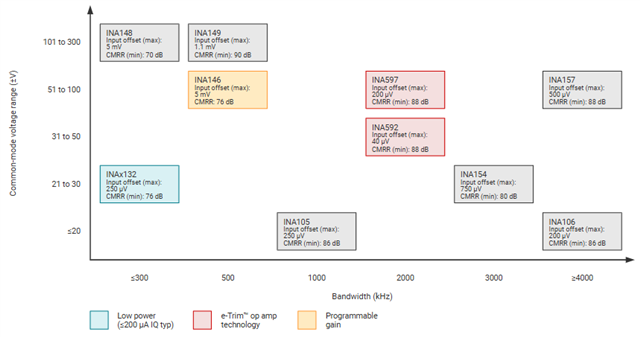

    Recommendation on switching to INA (e.g., INA333) or other instrumentation amplifiers
    You can try the following difference amplifier IC and see if there are improvements.
    https://www.ti.com/amplifier-circuit/difference/overview.html
    Instrumentation amplifier topology (1 + Gains) won't help you since you want to attenuate the HV line by 1.58%. The difference amplifier is a better choice. However,
    1/CMRR_total = 1/CMRR_opa192 + 1/CMRR_resistor_matching_network
    So if the resistor matching in the difference amplifier is poor, then the overall CMRR will suffer (even though you are using the high CMRR OPA192).
