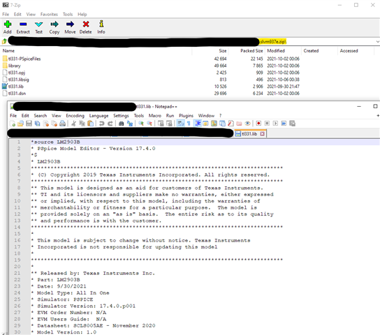

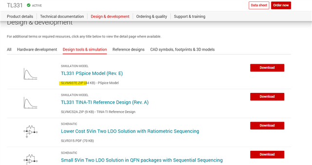

Hello, I want to download the PSpice model of the TL331 opamp, but the model uploaded on your website gives me the model for the LM2903B comparator instead. Everything except the actual model definition calls it the TL331. The LM2903B design files does not have the TL331 model in it.
Can you please send me the the TL331 PSpice model?

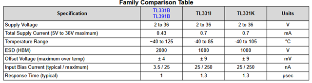

    The LM2903B is the dual channel version of the TL331B, and the TL331B is a newer version of the TL331. Other than propagation delay, offset, and supply voltage differences, you can use the LM2903B model for the TL331.
