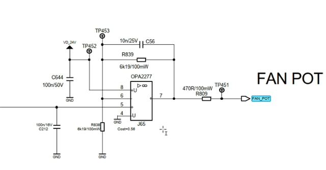

Customer Siemens used below OPA2277 circuit. (Rf/R839 = R1/R838 = 6.19Kohm)
They have been using below test way to decide if it the IC/functions well in their production line:
  • Input 0V to PIN5
  • Measure Vout (TP451)
  • They expected Vout should be within 1V
  • Actually, in previous material shipped, OPA2277 did performed like this, means Vout within 1V for 0V VIN.

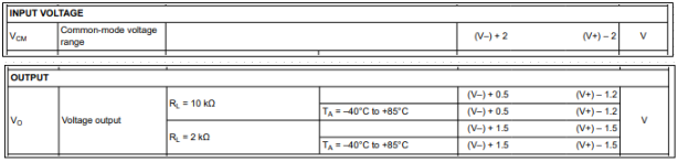

1) If above testing way make sense? Is the 0V input already violated the spec. of input range? [V- + 2 to V+ - 2]
    Yes, you are correct. The input Vcm range is 2V above Vee or V-, so the test condition at 0Vdc has no meaning (outside of the op amp's linear operating range).

    3) I think there is some modification required for this circuit. As VOUT for the load of FAN_POT would be starting to work on 2V voltage. But currently circuit seems not able to be guarantee min. output at 2V, unless they change circuit to a Follower.

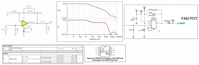

    Could you send the OPA2277 image over and we can verify the post-PCN production? The simulation below is the still pre-PCN OPA2277's behavior, but the input has to be operated in a linear region.

  • Supply is 24V and 0V, no requirement for BW.
    VIN min will be as low as 0V ideally, it comes from a DAC.
    Would be any other better p2p solution can be introduced? Dual channel, SOIC-8.
  • Hi Rocky,
    The image is shown that this is post-PCN OPA2277UA op amp, A grade (U is a better grade).
    The post-PCN has a wider GBW than pre-PCN, shown below. The datasheet has not been updated.

    TI does not guarantee the non-linear operating behavior. In this case, Vin=0V violates the input Vcm range, and the op amp is operating in non-linear mode. The minimum input Vcm is 2V above GND, and Vout can not be guarantee to be within 1V if the input Vcm does not meet the linear input Vcm range. And the best option is to change the op amp or change the input Vcm range.
