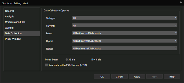

    Most of our comparator models are unencrypted, so you can make modifications through changing the tlv1h103-sep.lib included in the .zip file for the PSpice model.
    Turn on the "All" option in data collection in the "Edit simulation profile" so that PSpice will save the internal nodes (since you'll be unable to descend into the model's hierarchy):
    I made some alterations on my end to try to get it to work, but there was an issue with the LATCH subcircuit that is causing some glitches in my sims. I'll take a deeper look into it to see if I can rewrite the block.
