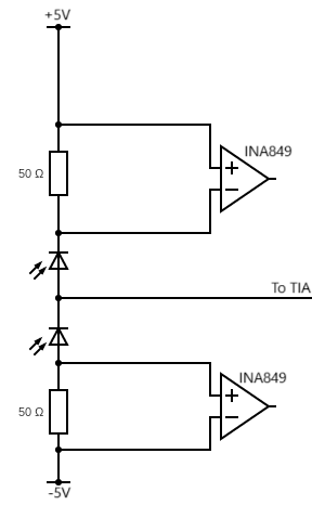

Need to builder monitor outputs for balanced detector and below is the rough schematic. Does this circuit have path to ground for the input bias current of the INA849?

The input bias current has a path to ground through the +5V and -5V supplies, so there are no concerns about return path with this schematic.
