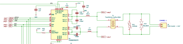

we are working on a prototype consisting of TAS5822M which is configured with a microchip microcontroller.
So far, we have configured correctly the Amplifier (as PBTL mono) and we are sending the I2S signal.
If we power up the amplifier at 8/9 Volt no error is shown, we can see the right signal in the output channel.
If we power up the amplifier at higher voltage, even 100/200 mV higher it doesn't work and it shows OC error for both channels in the register 0x70.
These are the registers that were read when the amplifier is powered by a voltage > 8V:
0x68 -> 0x01
0x70 -> 0x03
0x71 -> 0x00
0x72 -> 0x00
0x73 -> 0x00
We also tried to increase the voltage after the start up. Initially we powered up the amplifier with 8V and by increasing the PVDD it works untill 20 Volt then it shuts down (the audio signal in the output becomes nothing).
We also burnt one amplifier while trying to use a higher voltage to power it up.
