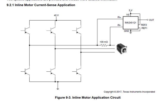

Can INA186-Q1 be used as Inline motor current sense? Just as INA240-Q1:
Thanks!
BRs,
Leo
Hi Leo,
No the INA186 cannot be used in-line because it doesn't have PWM rejection like the INA240. For more information, please see the following video: https://www.ti.com/video/5239618184001
