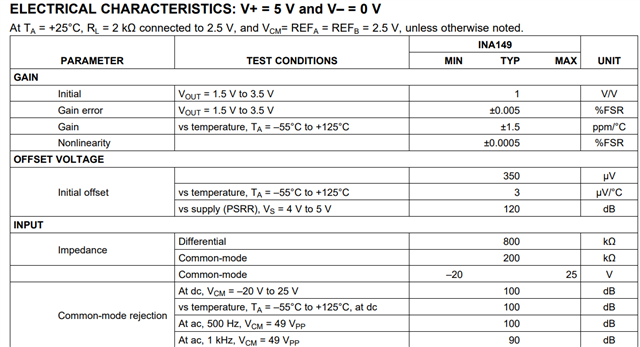

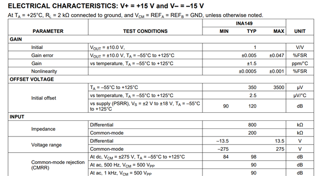

For the V62/12614-01XE:
- Which parameters are production tested?
- The first table below has only typical values for some parameters. I would like to know if there is a min or max value for gain, gain error and CMRR that could be provided?
- The second table has only typical values for some parameters too, also looking for min or max values for gain, gain error and CMRR.

    We do not generally provide details on which parameters are production tested but we ensure that all devices are within min/max limits as stated. Please see the VID footnote that states this.
    Is the customer planning to use the device at 5V supply? I would like to understand why they are needing to know all the different min/max values for those parameters.
    We have the appropriate min/max values for the specs you listed and not all specifications need max values like CMRR.
