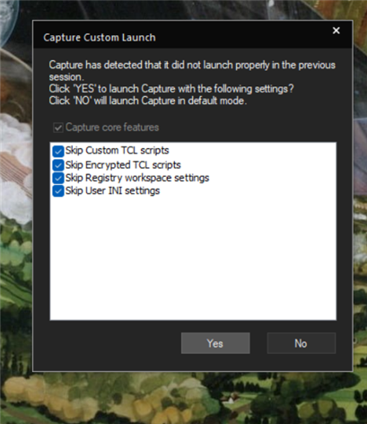

Could you help me with this? The TI PSPICE was working fine for three months and now every time I try to launch it displays an error message.

Currently there is a licensing issue with Cadence for PSpice for TI that we are urgently working to get fixed. This is affecting all users of PSpice for TI (even us, internally).
We're very sorry for this inconvenience.

This should be resolved. If you still see licensing issues when opening PSpice for TI, re-installing has fixed it on my end.
