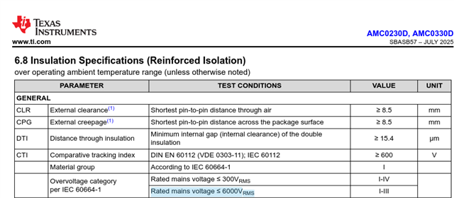

There is a typing error in the datasheet of the AMC0x30D in section "6.8 Insulation Specifications (Reinforced Isolation)" on page 7.
The test conditions for the parameter "Overvoltage category per IEC 60664-1" is stated as "Rated mains voltage ≤ 6000VRMS". I think it should be 600VRMS.

  • Hello Kilian,
    thanks for reporting this issue to us. I acknowledge that this is a typo. It should have listed 600V_RMS.
    We are in the process of releasing the whole family of devices and some typos slip through reviews.
    I appreciate your time informing us. I informed the datasheet author and we get it fixed (as fast as possible, however there is a release process for that) .
