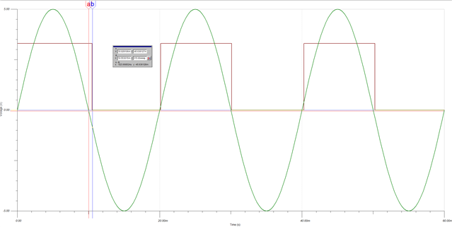

       We are trying to convert a 50Hz, -5V to 5V sine wave to the corresponded  0V to 3.3V square wave with TLV1872. After simulation, we found something interesting and would like to consult with you experts.
       First, the propagation delay is as long as about 500us which is thousand times longer than the spec.
       Second, the propagation delay varies over the waveform cycles; the deviation is as much as 1ms.
Is there any slew rate or frequency limit to its input? The threshold (reference voltage) is set to 0V.

  • Hi Henry,
    Any way you can share with me your simulation file? Usually, discrepancies in the propagation delay can be attributed to the timestep of the transient sim.

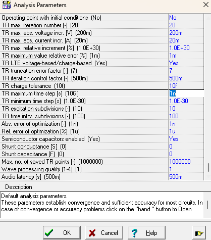

    Please try going to "Analysis" -> "Set Analysis Parameters" and change the max timestep to 1ns:

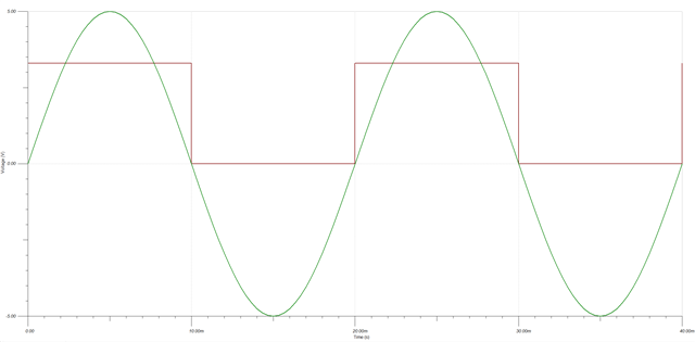

  • Hello Ho,
          Thanks for your prompt response. After changing the analysis parameters accordingly, the discrepancy in the propagation delay did disappear! Although the simulation time increases a lot from several seconds to ten's of minutes. We tried to simulate with another comparator TLV1805 under the same default parameters but found little deviation of propagation delay. These results are interesting and it's kind of you to let us know the difference if possible.

  • Hi Henry,
    Yes, the simulation time increased due to the lower maximum time step. This is because if you lower the time step, the waveform will have more points: number of points = data saved simulation time / time step.
