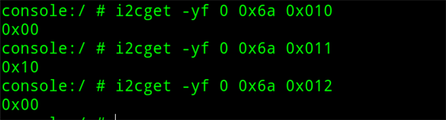

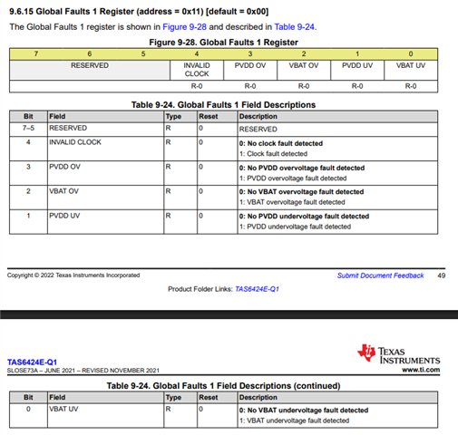

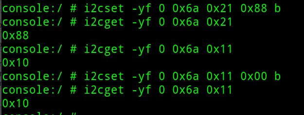

Hi Ti Team,

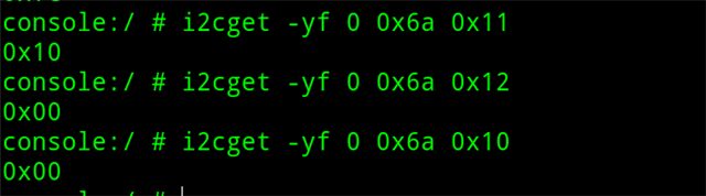

We are using the QWM2290 chipset. We are connected the speaker on the 4th channel of the amplifier, we have flashed same image on both devices.
In one of the board the audio is working fine but another board not getting audio output in all channels.
we have compared all the register values between these two boards and we have observed some mismatch in register(0x0f) values between the working and issue board. Please find the observation below,
1. working board,
0x0f -> Channel State Reporting Register ,the value 0xFC indicates that Channel 4 is in a play state, while the other channels are in DC load diagnostic mode.
0x04 -> Channel State Control , all channels are play state.

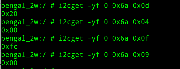

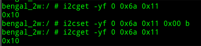

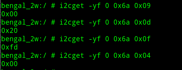

2. Issue board,
0x0f -> Channel State Reporting Register , the value 0xFC indicates that Channel 4 is in a Hi-Z state, while the other channels are in DC load diagnostic mode.
Please help to solve this issue.
