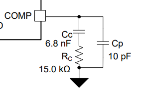

  • Thank you for your suggestions on the PCB layout. I am having a bit of trouble following the math for the loop stability and compensation section. I tried the Webench tool and got Rcomp = 365kΩ and Ccomp = 380pF. Do these values seem more correct?
  • I think the Webench may not consider the 2x470uF electric capacitor on the PVCC, considering these two big capacitor, I think Rcomp should be 200kohm and Ccomp should be 10nF, this make more sense.

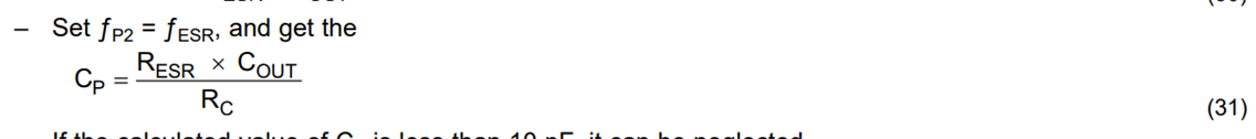

    Also a parallel capacitor on the COMP pin is required as shown below, the value of the Cp is related to the ESR of the 470uF electric capacitor, please check the datasheet of the capacitor and get the value based on the equation 31 in datasheet.
    Nathan
  • Thank you for the response. In the calculations, did you use Rout as 4Ω (just curious how that calculation works)? Also using two 470µF capacitors with an ESR of 0.05Ω each, would I use Resr as 0.05Ω (Cp ~ 220pF) or Resr as 0.025Ω (Cp ~ 110pF)?
  • Hi Ronak,
    The Rout is the load resistor of Boost instead of the amplifier, considering the output voltage of Boost is 20V, and maximum current is 2.6A, the Rout should be 20 / 2.6 = ~7.7ohm, and the ESR here should be 0.025ohm.
