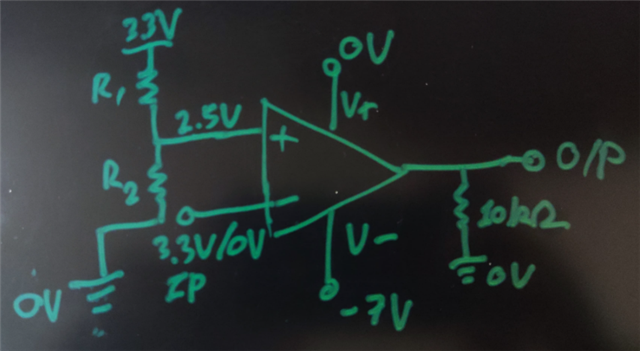

I want to use this comparator for an application where I need to translate 3.3V logic to -7V. I plan to supply this comparator with -7V to Vs- and 0V to Vs+. Is this IC suitable for such an application?

Supply +3.3V and -7V power to comparator. Output VOL will be -7V and VOH will depend on pull up resistor. Pull up to 0V for this application.

Would it be an issue if I apply 0V to Vs+?
I'm a bit unsure about using this IC, as the datasheet doesn't mention whether it's bipolar or not.
Below is the circuit I am planning to implement:
Gandhi,
Your inputs are now outside the VCM range. So that is bad.

Hi Gandhi,
Place +3.3V on V+ to accept positive voltages and you should be good. Output will still swing between 0V and -7V.
