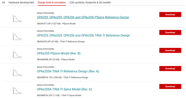

I am currently evaluating the use of the OPA2205 op-amp in attenuator mode, specifically with a gain configuration of less than unity (approximately 0.6). During my research, I came across several articles discussing potential instability issues when operating op-amps in attenuator mode.
Given this, I wanted to check if any additional compensation circuitry is recommended or required to ensure stable operation in this configuration. If there are any application notes, design guidelines, or best practices specific to the OPA2205 in such scenarios, I would greatly appreciate it if you could share them.
