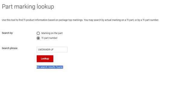

Hi TI,
I tried to look up the marking information for LM2904DR-JF by using part marking lookup tool, but the result was "No search results found".
Would you mind sharing the reason behind this?
Thank you.

Hi Grace,
I see the E2E thread below, that this is manufactured by TI based on Carrie's comments. The suffix -JF is a traceability code.
LM2904DR is SOIC-8 standard package.

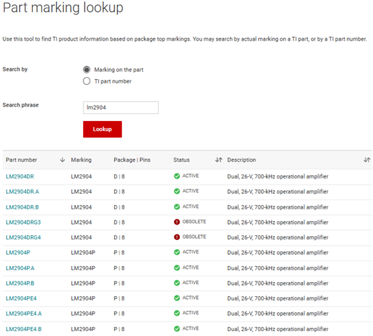

BTW, LM2904XX parts have issued PCN in recently years. If you see that the post-PCN did not perform identically or check out with pre-PCN LM2904DR, this is not surprising. This is due to the new FAB process and it is known among customers.
mm.digikey.com/.../PCN20230627002.1.pdf
If you are looking up the part, search LM2904 instead.
LM2904D-JF is obsolete, see the link below.
If you have other questions, please let us know.
