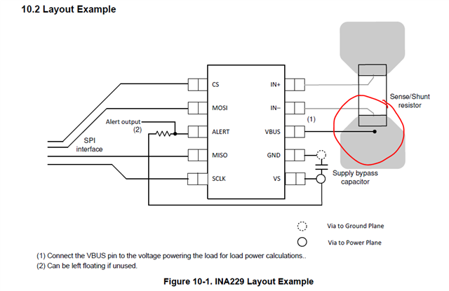

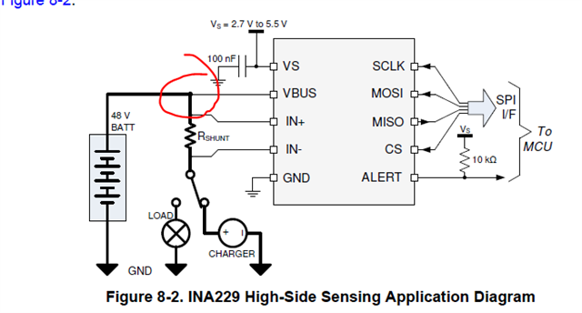

Part Number: INA229
In the typical application, the VBUS is connected to IN+.
In the layout, the VBUS is connected to IN-.
Is it a mistake here?

Hi Liping,
Both connection are valid, if you connect VBUS to IN+, you'll be factoring in the power consumption from the INA229 in the power calculations. If you connect VBUS to the IN-, it will not include the drop across the resistor.
