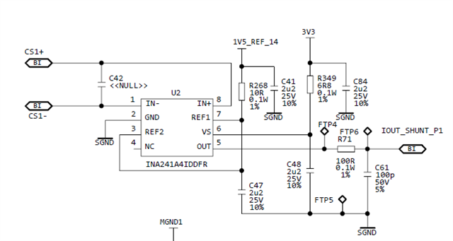

We are trying to use this chip to sample current (range +/- 100A ) in high side with ~5V common voltage.
However we are not able do frequency compensation by parallel capacitors with gain resistors, as the resistors to set the gain are embedded inside the chip, which we have practiced in other amps such as OPA388.
we have tried to add filter in the front but result is not very good as previous pracitice.
Any suggestion?
