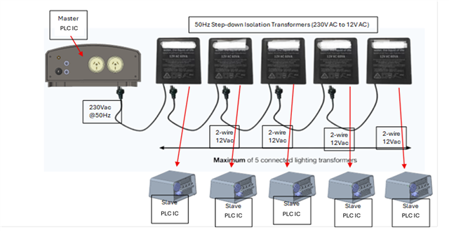

  • Thank you Alec. To answer your question, having X2-class capacitors instead of transformer where the PCL IC taps to the power lines is a must.
    Further more to give you a bit of an insight to our challenge, the following depicts the type of control we want to achieve and the challenges. As you can see the Master PLC IC needs to communicate to the slave units via a step-down isolation transformer (230V AC to 12V AC) designed for 50 Hz which will likely attenuate and cancel the high-frequency PLC signal. The Isolation transformers are daisy chained in series so the 230Vac supply is all connected together with no obstructions. Only the 12Vac to the Slave PLC IC needs to go through the isolation transformer. The on the secondary side of the transformers to the Slave PLC IC  is a normal 2-wire stranded power copper cable from 20 to 40 metres long.
    To get around this problem in the current isolation transformer, we will add a another and appropriate PLC transformer designed for PLC signal coupling, not power transfer, with a turns ratio of 1:4 (step-up), 20 µH min inductance at 2 MHz. Is this something you seen other customers doing when faced with a similar type of application?
  • Hello Sergio,
    Thank you for sharing your transformer details & system-level setup.  I do not see an issue with the implementation you have selected; we have also seen our devices used with more inductive loads than the transformer you selected.
    I will look into this setup more for you.
