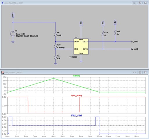

We're trying to use the tlv6710 and are encountering some issues.
I've also read some forum discussions and I'm pointing out that the INA+ should not exceed 1.7 V.
I downloaded the tlv6710 model and I notice that the OUTA voltage is 2.5 V when I expect it to be 0 V. I've attached the simulation.
Is this a normal behavior of the integrated circuit or a model issue?
  • Hello Christophe,
    It is the model. The model is designed to force the output to VCC/2 when ever the inputs are violated (either input >1.7V)
    The real device will NOT do this, but the output is not guaranteed when violating the input range on the real device.
