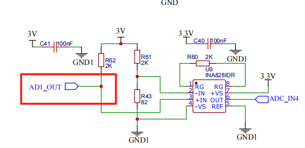

INA828: INA828IDR 25 year batch cannot read temperature, ADC_oUT is significantly different
Part Number: INA828
Other Parts Discussed in Thread: INA823

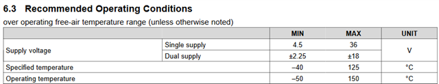

The INA828IDR old batch of goods can be used normally for DC23+ and DC24+, with normal values. However, after the chips in the DC25+are soldered, the temperature cannot be read, resulting in a significant difference in ADC-OUT values.
