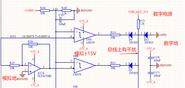

LM339: incorrect outputs
Part Number: LM339
When comparing analog quantities with the LM339 and using it for hardware overcurrent judgment, it was found that under some special working conditions, the LM339 would be interfered with and produce incorrect outputs. Could you please help check if there are any design issues?
