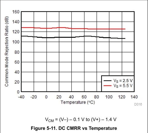

The CMRR spec. is 86dB at Vs=2.5V and 95dB at Vs=5.5V
The figure 5-11 has different results.
Which one is correct?

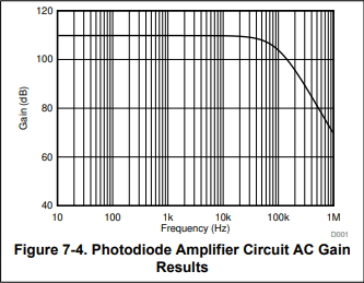

Figure 5-11 is just one sample, figure 7-4 is many samples. Perhaps one or more of these curves is 125dB. The top curve looks close to 95dB.
So expect variance in CMRR.
Top line
Figure 7-4 in LMV358A datasheet is this one:
Yes, it is. Why is this noteworthy?
my question is CMRR vs temperature
That one sample used in figure 5-11 is that, CMRR versus temperature.
