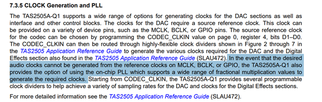

in my application, TAS2505A-Q1 will be driver by AM62P54, due to AM62P54 no such clock out to TAS2505A-Q1, does this clock input must have? if can be not used, how to handle this PIN? connect to GND/VCC?
thanks!
