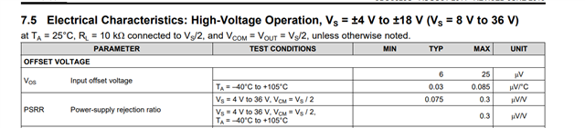

Hi expert,
Why Vos of OPA2188 only has positive value w/o negative value?
BR,
Zach
  • Hello Zach,
    This is an older datasheet using an older convention.
    ALWAYS assume the offset number is +/- unless it specifically shows a sign (like "+6mV" or "-6mV").
    So you should assume ±6uV typ and ±25uV max.
