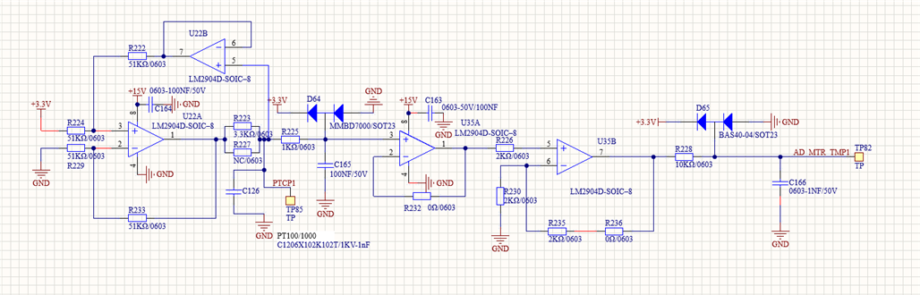

The schematic diagram is shown as follows. This is a temperature sampling circuit for the gun head of one charging gun. The actual main control board has four such circuits. This is the temperature sampling design for the charging gun head. Fault phenomenon: The PIN5 of the LM2904 operational amplifier chip is prone to damage. After testing the ground impedance, a short circuit was found. Please help check where the design is wrong and offer suggestions for improvement. Thank you
